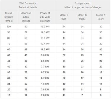

The Model X is a heavier vehicle so it only gets 8 miles per 4.8kwh and has a range of 237 miles for a 75kWh battery. Makes sense since the Model X is a heavier vehicle than the Model 3. But the Cybertruck and the Model 3 both gain 15 miles per 4.8kWh (per my calculation)so they must have similar range and weight.
The Model 3 LR weighs 4072 lbs. Elon stated that the Cybertruck and the F150 are the same weight. The F150 goes from 4000 lbs to 5600 lbs, and we don’t know which version he was referring to. The Model X weighs in at 5200 lbs, so to charge at the same rate as the Model 3 the Cybertruck must be closer to the lower end of the F150 weight range.
So for both the Model 3 and the Cybertruck that would be 62kWh for 250 miles, 75kWh for 300 miles, and 125-135kWh for 500 miles.

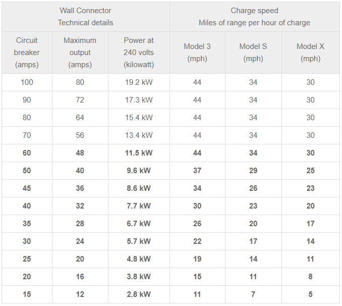

I found a revised chart that rates the Model 3 charge rate at 19 miles for 4800Watts. So the Cybertruck at 15 miles per 4800 Watts would be closer to the Model S at 14 miles per 4800 Watts. This also jives with 4800/15 = 320 Wh which is about the rate per mile for the Model S. I’m fairly confident now that the Cybertruck will be similar in Wh per mile/weight/range/battery size to the model S.
So for the Cybertruck that would be 75kWh for 250 miles, 90kWh for 300 miles, and 150-160kWh for 500 miles.
