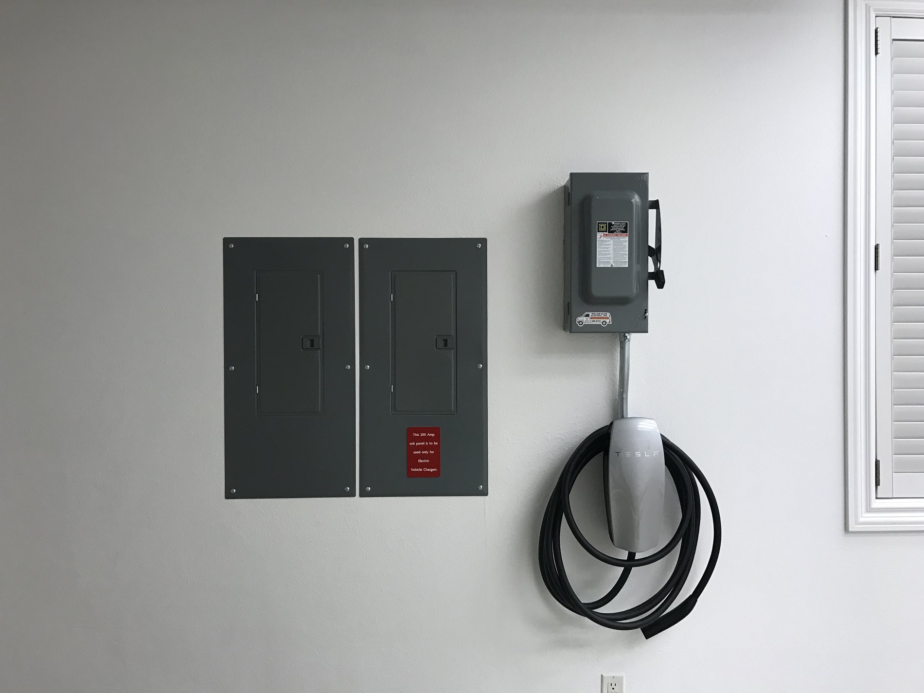

I already had 400A/240V service, so when buying my Tesla I had a new main 400A panel with separately metered 2x 200A feeds and 200A sub-panels installed. This allows me to get the lowest rate on EV charging on a time-of-use meter, and run a non-TOU meter for rest of house on the other 200A sub-panel. The standard Tesla wall connector is on a 100A switch, 90A circuit breaker, and the car is set to charge at 72A (17kW). I can add a second Tesla wall connector for the other garage when the CyberTruck arrives. (PS: the 2nd feed to the rest of house runs through a 200A transfer switch for emergency generator.)
That's the exact setup I want, thanks (including the transfer switch).
We don't have TOU here, but 2 meters would keep both of them out of tier 4.
Very nice. Looks like a great setup.
