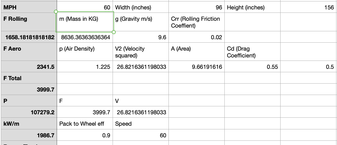

I am not sure I understand the variables values you are using.
Can you tell me what you used for
1. total weight & what items are included in that number
2. Coefficient of drag for Cybertruck
3. Coefficient of drag for trailer
4. area of front of Cybertruck
5. area of front of trailer
6. speed

1. 5,000 pounds for Cybertruck, 14,000 pounds for 5th wheel.
2. & 3. 0.55 Which is actually a rather good number for a truck and 5th wheel. The CD of either is irrelevant and you need to use the CD of both together.
4. & 5. 9.66 sq/m
6. 60 MPH

What answers do you get for
1. total weight: 11,000 lbs ( 4,990 kg )
--- (tow vehicle, 2 people (400lbs), bags (400lbs), misc stuff (120 lbs), trailer ( 6,000lbs)
2. Coefficient of drag for tow vehicle: 0.25
3. Coefficient of drag for trailer: 0.55
4. area of front of tow vehicle: 25 square ft ( 2.31 sq meters )
5. area of front of trailer: 76.5 sq ft ( 7.124 sq meters = 2.60m x 2.74m)
6. speed: 56 mph ( 90 k/h )
I get that you are smoking some real good shit if you think the Cybertruck is going to have a CD of .25. Pass it over man! :)
I did not say the tow vehicle was a Cybertruck.
Is your spreadsheet able to handle is calculation?

Maybe a 5,000 pound travel trailer, yes. But just doing the math on a fifth wheel travel trailer weighing 14,000 pounds, and I get an energy requirement of around 2,000Wh/mi. Are you suggesting the CT will come with a 560kWh battery?

I am not your technical support.
There are several real world examples of EVs towing that resulted in about 50% reduction in range. Real world towing examples from ICE trucks pulling 10K-14K lbs trailers are similar (40% reduction). So based on this info & the difference in Cybertruck I have posited that Cybertruck towing might be around a 50% reduction even at 14,000 lbs.
Your prediction of 2,000Wh/mi. that you claim to have made scientifically using your spreadsheet is way out of range.
I don't think anyone should rely on that claim without more validation.
If you do not want to backup it up with anything that is fine too.
Carl Sagan: Extraordinary Claims Require Extraordinary Evidence
