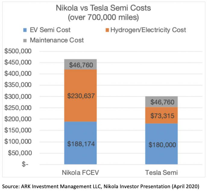

Taken From Ark Invest website:
1. Nikola Plans to Enter the Market at an Uncompetitive Price Point
Founded to develop hydrogen fuel cell class 8 trucks, Nikola Motor Corporation made headlines this past week as its stock debuted via reverse merger and hit a $30 billion market cap, even though it has not produced one truck. Nikola aims to lower the cost of trucking. ARK’s research suggests, however, that hydrogen trucks will have a higher total cost of ownership than their battery-electric alternatives, as shown below.
While hydrogen costs and hydrogen drivetrain inefficiencies are key to the difference between hydrogen fuel and electric truck costs, perhaps the more important competitive obstacle will be the infrastructure for hydrogen refueling which is an order of magnitude more expensive than charging stations for battery electric vehicles. Assuming incorrectly that most trucks max out on weight before running out of trailer space, advocates for hydrogen fuel cell trucks often claim that the weight of the batteries will limit the freight an electric truck can transport.
ARK will be surprised if Nikola ever delivers a single fuel cell truck.
This cost doesn't include the price of paying a driver to stand around and recharge, nor the limitation of miles that would make in a 'travel day', and assumes worst price for hydrogen per mile while assuming a ridiculously low electricity price of 5¢ per kwh (<1/5th avg US) at the supercharger?
I don't think Nikola's plan will work because they don't have a fueling network yet but that chart doesn't work out.
One of the advantages of hydrogen is that you are using a medium of storage so you can buy the cheaper electricity whereas you can't if you're not.
So the plan is to take cheap electricity, turn it into more expensive hydrogen to run a fuel cell which converts that hydrogen into electricity to run the motor.
I’d rather just use the cheap electricity.
The plan to to take cheap electricity and convert it to hydrogen such that when it is converted back to electricity its cost is about the same as if you bought the electricity from a SC or fast charger BUT in addition to allow you to take on 300 miles additional range in 5 minutes and store it in a few kg of H2 + tank rather than 600 kg of additional battery. You don't get cheap electricity at a super charger. You get it at home but for running around home you don't need 300 mi extra range.
