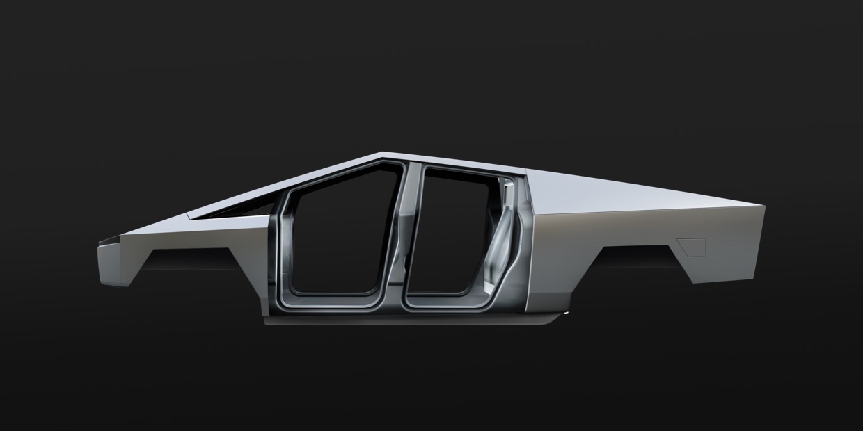

I think we are really saying mostly the same thing. The roof rails are essentially a box beam in a complex shape. They may need to be thicker than 3 mm. The battery compartment is also a box beam. The lid to the battery compartment might be considered the flange with the battery being the web. The CT basically forms a triangle, which is a very efficient section the whole truck is a truss. I am so pumped about the shape.Batteries in the frame, interesting...
Yes, the roof peak definitely, both lateral sides and more importantly the cargo structure I believe will be a full frame, it needs to withstand 3500lbs of load
