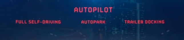

from the reveal
I am betting those cameras are for the trailer docking.
