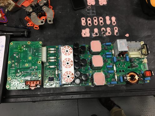

Sounds like even current Teslas are already equipped for vehicle-to-grid and it can be enabled simply via OTA update.
Per Electrek today:
An engineer involved in a Model 3 teardown shows that Tesla's onboard charger is bi-directional charging-ready. Tesla could enable vehicle-to-grid in 100,000s of vehicles whenever.
Electrek has learned that Tesla has already prepared its onboard vehicle charger for bidirectional charging.
Marco Gaxiola, an electrical engineer who participated in a Model 3 teardown for a Tesla competitor, reverse engineered the electric car’s charger and found it to be ready for bidirectional charging.
He told Electrek:
What I learned on reverse engineering the Model 3 charger, was that the design is fully bidirectional. This means power can be converted from AC to DC the same way as the previous example, but also power can flow in reverse direction, coming from the battery and ending up on the AC side. This is known as DC to AC inverter, and when this technology is present in a vehicle, it is known as V2G (Vehicle to Grid).
Here’s a schematic of the charger that Gaxiola produced as part of the reverse-engineering of the vehicle:
The engineer added about the design of Tesla’s onboard charger:
To complement this, the bidirectional design is replicated 3 times across the same PCB on the Model 3 charger. Another example of redundant design that assures a working process even if one of the circuits fails. Additionally, it is 3 phase design, so it can be used worldwide.
Gaxiola believes that the vehicle to grid capacity in the Model 3 could be enabled through an over-the-air software update.
What that circuit shows is, from left to right a rectifier (6 transistors), inverter (4 transistors), step up transformer and rectifier (4 transistors) which is capable of turning 1 or 3 phase AC from 120 to 240 volts 400 VDC with all the controls necessary to regulate that output voltage. Do you see any difference between the circuits on either side of the transformer? Each is 4 transistors in a bridge and yet I identified one as an inverter and the other as a rectifier. What makes one an inverter and the other a rectifier? The gating of the transistors. The gating circuitry is not shown nor is the firmware that is required to properly command the gating circuits. While it is true that the circuit as shown could be the basis of a design used to pass power in either direction that's because the rectifying voltage converting regulating features of the circuit require that it use a design which is intrinsically bi directional not be cause bidirectionality is a design requirement. It's like a garden hose required to transfer water from the bib to the sprinkler. Even though that's what its for it can equally well transfer water from the sprinkler to the bib. The gating circuitry is not present (AFAIK) in the current chargers to send power in the reverse direction. Also missing is the hardware and software to manage the required safety, regulation, communications and interface features required for V2G. The "rectifier" module in the current cars is NOT capable of V2G and a software update cannot make it so.
Now there is a place in the cars where bridges do send power in either direction and that's the inverters. When driving DC is converted to AC for the motors. During regen AC is converted to DC to flow back to the battery.
A couple more comments on the schematic (I nerd-out on such things).
This was the old design for the S and X. It has 3 identical modules and older S and X used to offer the option of having all slots populated (my old X charged at up to 72 A). In the more recent production maximum charging rage is limited to 48 A. Don't know if the current design is still based on 24 A modules but if it is there would only be 2.
The unit in the picture would have circuitry designed to prevent feeding power back to the grid because the version of the code in effect when it was designed required that.
The newer "rectifiers" are more efficient than the old by a couple of percent. I see efficiencies of over 90% in the newer Raven X. So something is changed. I tried to point out in the last post that given the design requirements for a Level 2 charger most people would probably come up with something very close to what is in the schematic. But I do question the use of the first bridge as a rectifier. As those transistors can be switched any time I want them to why not use them as a ring modulator i.e. instead homodyning down to DC and then modulating that onto a 20 or 40 kHz (requiring the inverter) why not just modulate the carrier with the line AC. Instead of a pure sine at the transformer secondary we'd have the carrier (40 kHz) plus an assortment of 60 Hz sidebands but so what? The secondary side rectifier can turn that into DC just as well as it can a single sine. This scheme eliminated the inverter and the attendant losses of its 4 transistors. Someone who really understands this stuff might easily shoot it down but I have been wondering about it.
The place where the circuitry in the schematic (or a modernized version of it perhaps sans the 4 extra transistors) could really be used as an inverter is in the bed power supply. Note that the transformers completely isolate the three modules on A/C side. Each is a 3ø 50 or 60 Hz supply. There is lots of flexibility in how these can be connected to supply 3ø or split phase (which is just 3ø with one of the phases the neutral and the angle between the other two 180 instead of 120 °.) Thus I think the bed power in these trucks is probably going to be at least 30 A per phase and perhaps a bit more. Given all that perhaps the CT charger circuit will be the source for the bed power receptacles.
All speculation of course.
I wonder if thermal management across the secondary is why they use the first bridge as a rectifier. Greater efficiency may be possible if the thermal load could be managed. Perhaps that's the reasoning. Hopefully, the truck will have a lot of usable amperage from the outlets for those times when you want to run a circular saw on your new property... or at least be able to charge up your tools for the day.
