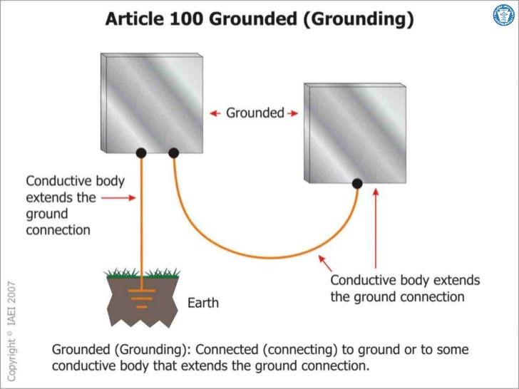

With this plug in place you have fooled the vehicle into thinking it is grounded. It isn't, of course,
By tying (bonding) neutral to the generators ground, you are grounding it.
To ground doesn’t have to mean connecting to dirt.
What you should do to be safe is properly ground it. To do this you would moisten a patch of ground, drive a ground rod into it an then tie that to the generator's frame via the lug provided for that purpose.
There is no reason to connect a portable generator to a rod driven into the dirt. Check with your generator documentation for verification.
I feel like we’ve been over this.
Clearly you don't understand anything about electricity. As such I would ask you to refrain from posting about it. The reason I making this request in this instance is because misinforming people about grounding has safety implications.
No need. I know what grounding means, what it is for and how it works. You have made it plain you don't. If concern for others safety isn't enough to make you mute yourself on this subject perhaps the fact that you are advertizing yourself a fool is.
If we have been you didn't learn from last time.
Here's my offer. Edit your post to remove it and I'll remove this one. Or perhaps an Administrator could just remove both. I am reporting your post as potentially dangerous.

I don’t have time for this foolishness.
Please explain exactly what is unsafe about using a portable generator without connecting it to the dirt.
Most plug in Hybrids are basically BEV’s with a generator. Explain how they do not require a ground rod in the dirt when the generator is running.
The last time we had this discussion I posted links from various government websites including OSHA if I remember correctly. Those agencies specifically stated you do not have to use a ground rod into the earth.
Look for my previous posts. Then I suggest you delete your posts. Otherwise I should have time tomorrow to properly show you with links and facts that you do not have to stick a rod in the dirt to run a portable generator to charge an EV.
It isn't earthed.
....OSHA if I remember correctly. Those agencies specifically stated you do not have to use a ground rod into the earth.
Nobody said you have to properly ground your system. If you are willing to accept the risk of charging an unearthed vehicle we have discussed above how to do it. We note that the various levels of government will not allow you to accept that risk at home or at a DC fast charger and look forward to seeing the OSHA documentation that says it's OK in the field.
Your understanding of electrical safety is clearly lacking. I don't believe you even understand what "grounding" really means means. There are lots of people on here whose knowledge is similarly inadequate. They may think you know what you are talking about. While I'm not going to lie awake worrying about it someone who accepts your ignorance could get hurt.

It isn't earthed
I was hoping you had a clue about electricity, specifically grounding. Obviously you don’t. If you did your answer might have had some meaning. Saying it’s unsafe because it’s unearthed would be like if you said it must be blue to be safe and I asked why and you replied because it isn’t blue.
People who understand electricity appreciate that a safe installation requires that any exposed conductive part of an electrical apparatus be earthed. There is an organization called the National Fire Protection Association and they publish a code called the National Electrical Code which goes into this at great length. Electrical practice in most of the world adheres to NEC or similar standards. Thus to people who use electricity the statement "It isn't safe because it isn't earthed" requires no explanation.
May I suggest https://en.wikipedia.org/wiki/Ground_(electricity)? Your misunderstanding of No. 23 is covered in the fifth paragraph but that's not the only reason I am pointing you to this article. I don't expect you will be able to understand much of it but perhaps you will grasp some.
