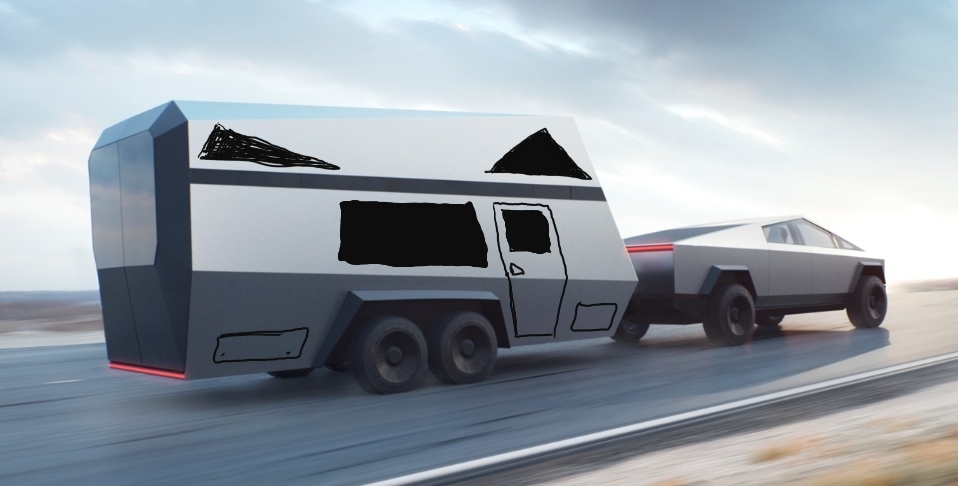

I really wish someone like Tesla would come out with a Stainless Steel Camper that looks like it was made for the Cybertruck. I dont really care for the look of Airstreams Shiny Rolling Twinky.
Build a Camper with lots of Solar Panels on the roof, perhaps even as part of the Awning . So you can charge your Cybertruck While camping as well as power all your glamping needs.
