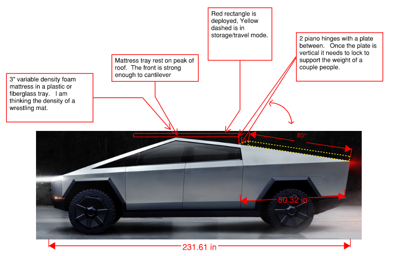

1.) This is from the Crowdsource Camper forum. I scaled the photo from Tesla's website using a 231.7" as the overall length using Bluebeam software.
I am assuming the advertised 6.5" vault would be an interior dimension. I guessed that the thickness of the tail gate at 2.3" The problem is , this puts the wall of the bed past the door. Assuming there is a couple inches of seat this area is not adding up in my mind.
2.) This got me thinking about the telescoping tailgate/ramp shown in the reveal. Knowing how I treat my trucks a little bit of muddy sand and some dents and that would quickly get gummed up. Anybody have more detail on the tailgate?

12x6.5 = 78" maybe that's the problem?

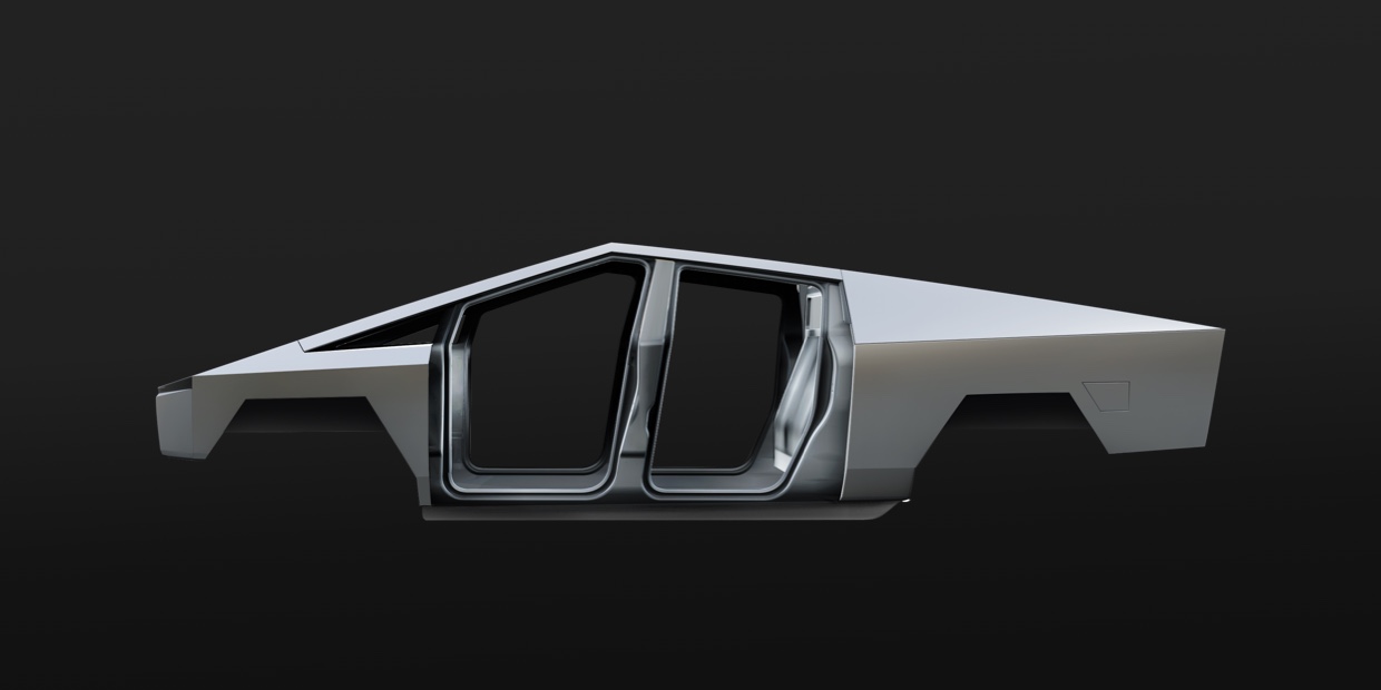

Also check out this pic the bulge at the back of the cab is where vault cover windup goes I believe

Thanks for the pic. That explains a lot. So the 6.5' is a little misleading it is a 3d equivalent of a parallelogram. You would not be able to fit a 6.5' box in there. All you hearse operators out there would only be able to handle short clients.
