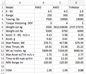

I wanted to keep #30 as simple as possible and so didn't comment on this. In fact it takes less energy to move the trailer with a BEV than with an ICE vehicle because some of the energy that goes to the trailer when it is towed by and ICE vehicle gets converted to heat in the trailers friction brakes. In an ideally executed tow with a BEV the brakes are never used and in a less than ideal situation are used less than they are than they would be with the ICE vehicle. IOW regen reduces the energy used by the trailer and it reduces the energy used by the truck. Based on #30 the reduction fraction isIt'll take the same amount of energy to move the trailer whether BEV or ICE if I understand correctly.
1/(1 + T/V)
in which T is the energy demand of the trailer and V the energy demand of the vehicle towing it. For a simple analysis we might assume that regen reduces those by the same factor, call it f. Then
1/(1 + f*T/f*V)
and we see that f cancels so the reduction is the same though regen clearly saves us total energy so while the reduction is smaller the distance we can go is longer. For example, the CT will give us 500 mi EPA with regen, Using the numbers from #30 we'd expect to see that reduced t0 0.4*500 = 200 with the trailer. Without regen the unburdened range might go down to 450 miles and with the trailer we would then expect to see 0.4 * 450 = 180 mi,
