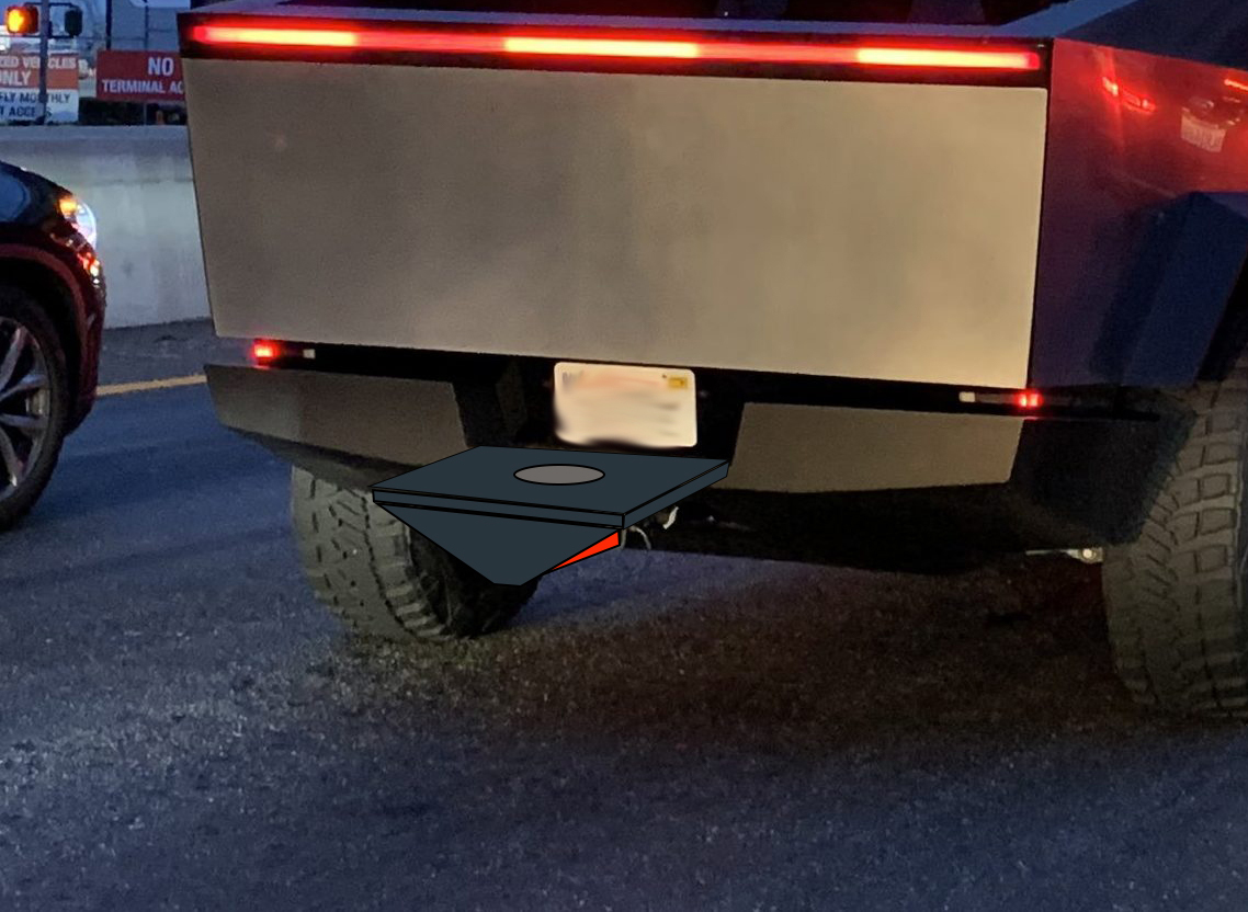

The Cyber Hitch Bumper Pull Receiver plate conveniently slide in, as the foot step.

The Cyber Hitch Bumper Pull Receiver plate when pulled out. Easily slides in when not in use. Easily slides out when you are going to tow something, or to be used with a Cyber Hitch Accessory. See the Accessory section.

Now, Get the same benefits as the 5th Wheel Cyber Hitch on your bumper!!!
Benifits:
Know that your hitch is locked and secured.
No Safety Chains, As per FHWA no safety chains are required for a 5th wheel device.
Careful here. This arrangement is missing two of the major advantages of a fifth wheel or gooseneck
1)Pivot point over or closer to the tractor axle
2)Tongue weight over or closer to the tractor axle
Though I will never tow anything but boats one of the things I am most curious about is whether missing 1) and 2) will make any difference is a vehicle with two rear motors as the sway torque problem presented by 1) can be compensated for by torque vectoring and loss of steering from 2) can also be compensated for by rear wheel torque vectoring. Also, of course, spring systems on the trailer that take weight off the tongue could be used.

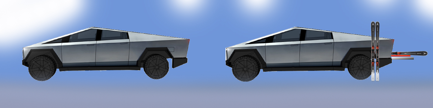

Your Cyber Hitch will never collect dust. We are designing accessories to be used when your not towing a trailer.
Cyber Hitch accessories for both the 5th Wheel in the bed attachment and for the bumper pull attachment.
We might outsource the Rack designs to other manufactures such as Yakima and Thule.
Do you have:
Road bikes or mountain bikes
Kayaks
Skis
Other Sport Equipment
How about a slide out tool box.
See below some concept designs for a Bike Rack and a ski rack.
Ah my friend ajdelange. I love your comments. :) People love options. We hear people who love their 5th Wheel, and people who love their bumper pull. They each have their advantages. Regardless what the Cybertruck can handle, or what advanced features the motors will provide. The fact remains that these Cybertruck owners want to pull trailers with their truck. There has been and still is a great concern from people who are interested in the Cybertruck and if it can tow trailers. I read it in every web site. The comment we see a lot is, "if it cant pull a trailer, then it is nothing more than a SUV". Honestly it is a pivit point on whether who will buy it, and who will not.
