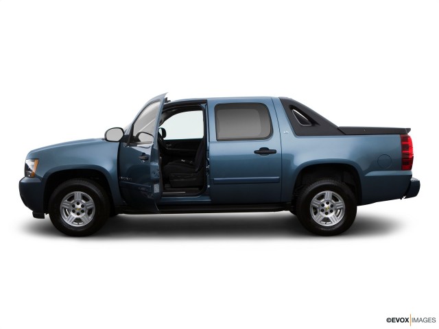

Yes, the obvious pattern is that none of those trucks sells in numbers anywhere close to a Ford F150 of GM 1500 with a conventional pickup bed (in the U.S.). The Avalanche is discontinued. The Ridgeline is redesigned this year to have a more conventional box. Toyota got into the pickup market with a conventional bed. So did Nissan.Notice a pattern?
... the pattern is that those unibody vehicles all have triangle shaped supports connecting the cab to the bed.Yes, the obvious pattern is that none of those trucks sells...
