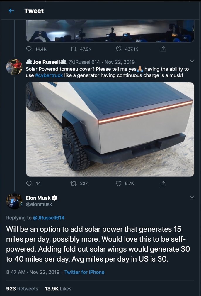

I just saw this and grabbed it for you.
During the Summer, we average 5.4 peak sun hours which would get me 15.43 miles with my 4 panels. Pretty close to what Elon said. Cool. This is quite possible.
In summer your insolation is 7.00 hr/da (average between the equinoxes and assuming optimum panel elevation of 54°) but you only receive 5.4 which means clouds, haze, rain etc. are letting 5.4/7.0 = 77% through. In winter your average insolation is 4.7 hr/da on averaage (again, between the equinoxes). Applying the same ratio for the winter means that your effective average insolation for that period would go down to 3.61 hr/da. And in the dreary month of December insolation goes down to 3.6 hrs per day and, with the same 77% factor for weather, that leaves you 2.8. Thus yes, in summer it is quite possible. In winter the picture is less rosy. What I'm trying to get across is that you cannot count on the best conditions pertaining all the time. Although I must have said it a dozen times already here and elsewhere, in citing performance Elon isn't going to pick the worst case. He's going to pick the best case and maybe even boost what his engineers calculated for best case a wee bit.
