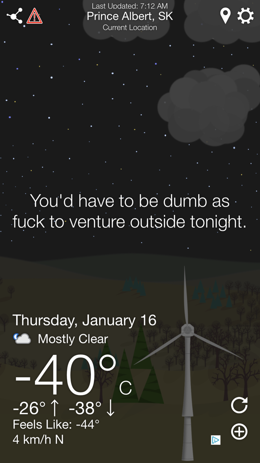

WTFORECAST has it right today. Maybe we will drive the kids to school today instead of making them walk.
