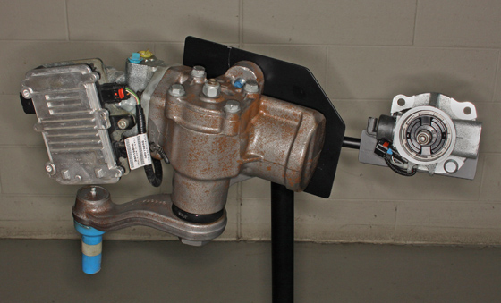

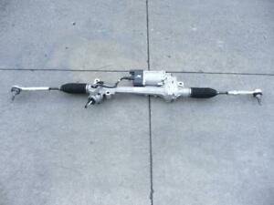

Traditional steering box and Tesla Model 3 rack and pinion steering rack.
Below: GM’s 2500 Pickups use DSA (digital steering assist). DSA is a computer-controlled hydraulic variable-assist steering system that makes GM HD pickups feel just as nimble as their half-ton counterparts, which have programmable electric power steering.
